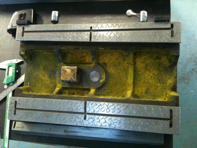

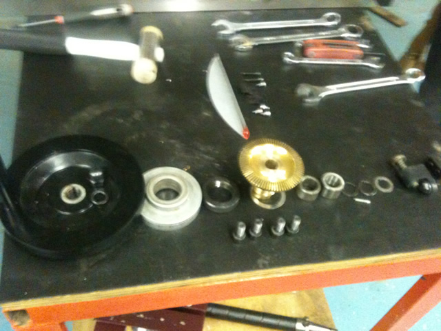

    First stage of the X axis ballscrew conversion, is to pull it all apart and make a few measurements.
    The table is heavy, so a trolley was set up and the knee height adjusted to take the load.
    The DRO and coolant drain disconnected, and the x-axis power feed, handwheel etc removed.
    Seems to me the critical measurement is the location of the center line of the ballscrew, the ballnut is slightly larger and that will move the center line down a few mm's. The old leadscrew nut appears to be cast bronze.
    No retaining bolts, just a pin.
    The bottom of the leadscrew nut is the recessed bronze pin on the right.

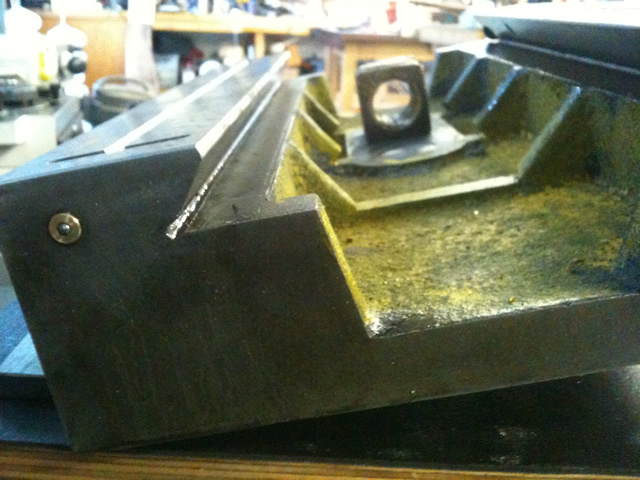

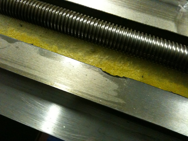

    The casting for the table has a bit broken, they probably thought no-one ever looks under here...
    The bits and pieces of the power feed end of the table.

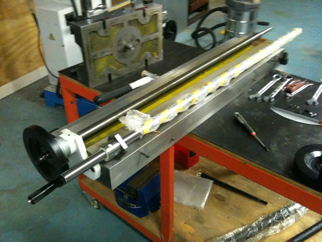

    The new ballscrew being accurately checked for length...
    The top of the Y-axis, what is that screw for?
    The plan is to design the parts required, get the measurements right. re-assemble the machine, make the parts, dissassemble again... install ballscrew and repeat until I get it right?
    One design decision has been made, and that is to fit the servo at the left hand end, that's where the existing (cheap and nasty) thrust bearing is located, and the free end is on the right hand side where the power feed is currently located.

    The edge missing on the table wont hurt as that part doesn't come into contact with anything anyway.
    The oil slot/passage needs to be fixed because when you pump the oil in it will go the easiest route out the side. I had a couple that come really close and used quick steel (after spot sand blasting) to plug the ends to stop the oil coming out. As it's setting (5-10 min) you shave it level with a stanley knife blade.
    I will be watching with interest on how you install the ball nut. Chich mounted it on one end, but reduces a bit of travel.

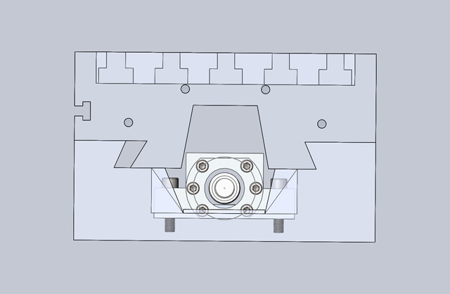

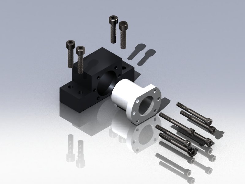

    Still thinking about the best way to mount the ballnut, this is how we are currently thinking
    Josh is the solidworks wizard, that did the drawing...
    The discussion point at present is how we machine the mounting point for the ballnut mount. I need another mill..
    The existing leadscrew center line is 19mm above the current mounting surface, the ballscrew will be 24mm if we use the same surface, so the centers of the bearing support will be 5mm lower than currently.
    Which oil paths were you referring to, and what would you recommend to change? ( EDIT ah, don't worry I get it!!, plug them)

    You can swivel the top of the saddle 180 clamp it down then mill it using the Y axis. If you are using a small cutter and need to make a few side by side passes swivel the head across by unlocking the column bolts.
    The picture looks good and I like the design. With the oil paths I cant see the end one's but those middle ones are cut through the sides were they should stop short.
    Dave

    I would be putting slots in the main ballnut housing to get a bit of sideways adjustment. A little out on alignment and the ballscrew binds - you will hear a grinding noise. You can adjust the mounting up with shim with that mount or skim a bit off to get it down. A slight twist in the nut itself will cause binding along the whole length of travel.
    Alternatively you can slot the ballscrew mounts on the ends of the table to do the same thing. May be the better way to do it because you have room to dowel it in place once you get it right.
    The ballscrew is most likely to bind near the ends as there is a little flex in the screw towards the middle travel.
    The nut on the standard screw floats a little for this reason but with a ballscrew you need to get this area aligned spot on.
    Hope that makes sense and I haven''t made it sound too difficult. As long as you have a little adjustment there and some patience it is quite doable.

    Good point Rod, that could be a problem... been thinking about the different ways we can align the ballnut rotation to solve that problem. Another problem is once we get it aligned, the capscrews bolting it to the crossslide are covered by the table, and can't be accessed to be locked down. So I'm thinking that the capscrews should come in from the bottom with either slots or slightly oversize holes and cut the thread in the mounting block. That way I could do the retaining screws finger tight, run the ballscrew end to end a few times to pull it into line and then tighten it up, run end to end a few more times, then install the table and crossslide as a single unit. That covers the alignment of rotational aspect of the ballnut.
    I'm thinking the free end (right hand side) will use the existing dowelled plate and bearing, to make that work we will have to machine the ballnut crossslide mounting down 5mm from the current surface, that means the axis of the ballscrew will be the the same as the axis of the existing leadscrew.
    At the servo end, we have the new servo mounting plate and AC bearing block, the plate mounting can be slotted so that it can be aligned to be on the same center as the free end. Then dowelled at that position. (Arrggh help...how do I transfer the existing dowell centers to the new plate?) (make some dowell points?)
    Josh has drawn up the assembly, and notes that we need to reference all our vertical measurements (for the machining) from the ground face of the crossslide.
    This is the crosssection view, at the ballnut location, the drawing needs to be re-done with the screws coming in from the other side, for reasons discussed above. but notice the clearance between the bottom of the table dovetail and the top corners of the ballnut. Looks like these will have to be chamfered to make sure we have plenty of clearance.
    Regards

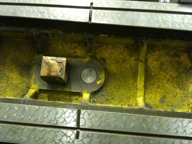

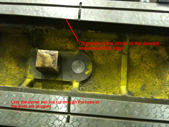

    Meantime, I am looking at the oil grooves at the bottom of the crossslide, I think that they are actually meant to be cut through the side, as there is an oil groove running along the corner of the dovetails. I'm thinking that this is to get oil into the dovetails.
    The oil grooves at the ends are stopped.
    Here is the picture I'm looking at..

    Edit: Here are some better pictures
    That groove in the corner, is what I'm thinking is an oil groove?

    I have never seen it done that way but I think you may be right, so leave it as it is.
    Is there a groove cut in the top side of gib as well, to get the oil over to the sliding surface between the gib and the table.
    I had a look a chich's and he seems to have a groove in the middle of the non gib side only.
    http://www.cnczone.com/forums/attach...1&d=1161409420
    Most mills have that groove in the corner on all dovetails, I am pretty sure it's just a relief for the dovetail cutter/grinder. I think in this case if anything to do with oil, it would be an oil drain being on the bottom.
