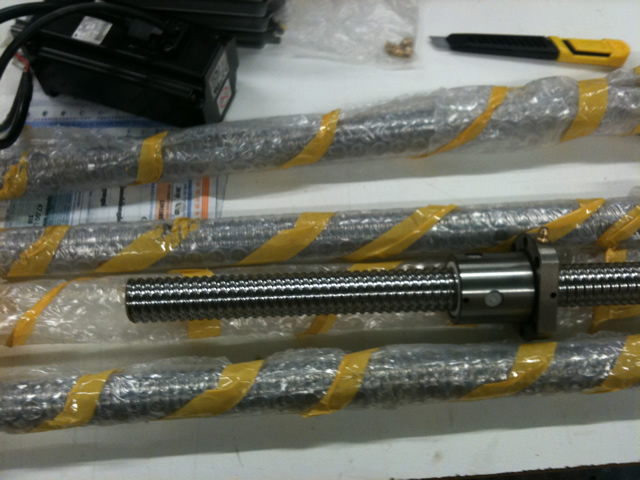

    The ballscrews arrived yesterday, (they are the anti-backlash type with the oversize ball bearings) and now I need to start thinking about how I set up to machine the ends. Can't actually do any machining until after the mill arrives, and I finalize the lengths. But I might as well be prepared.
    From what I've been able to glean by reading up on cnczone I need to get some soft jaws for the chuck and set up a bearing for the unsupported end.
    I'm going to use carbide insert cutters, I'm pretty sure they will cut the stuff ok. ?
    Any tips on what I need for machining ballscrew ends?
    I am not at all keen on removing the ballnuts, from what I hear they can be a real pain in the a** to get all the balls correctly back in the track, hopefully I can avoid having to do that.

    Hi Ray below is what I posted up on CNC zone which helped a few guys out putting them back to gether.
    Oil the ball screws up and keep them that way because they rust real quick. Mine got a couple of little spots in 2 weeks, I cleaned them up then wrapped them up in glad wrap well oiled.
    Machining the ends will have to be done through the head stock because there to long to go beyween centres. You wont need soft jaws just a 4 jaw and some scrap brass to protect the screw. I found some bits of crap in my ball nuts after I took them off so I am glad I did, it looked like plastic. I have not machined mine yet, but have read to just get under the case hardening with a decent cut and then you can thread and finish with HSS. Watch out for the little screws in the wippers there tiny and easy lost and if you do take the ball nuts off (which I recomend) do it on a plan clean cloth.
    Dave
    Origonal artical on CNC zone
    Chinese ball nuts & screw on Ebay - Page 3 - CNCzone.com-The Largest Machinist Community on the net!
    I received my ball screws in 5 days with a plastic mounting tube and 400 odd extra spare balls. I removed a couple of my 2505 ball nuts to inspect them as some were not spinning freely like the others. I was told by Chai that they are supposed to have 25 per circuit. I found that they had put an extra ball in 2 of the circuits on 1 of the nuts. After getting it back together it still didn’t move freely so apart it came again and I measured the balls of the one that moved freely and the one that was tight and found it had larger balls so I think they shipped me a few ant backlash nuts in the 8 that I ordered that I never asked for. I read back in this post about him saying they didn’t supply over size balls in his nuts well they do as I have at least 2 of them I haven’t gone through them all yet.
    escott76
    As for putting the balls back in I tried the tube that was supplied for transferring them but was unsuccessful so I machined up a shaft with a taper on the end that I had read on the internet somewhere still unsuccessful.
    I ended and the most successful way I come up with is:
    Set out each set of balls into groups. leave the plastic return pieces in the nut, put the plastic wiper on one end of the nut, holding the screw upright screw the nut on through the wiper until you see the 1st thread of the ball screw line up with the bottom of the lowest nut thread for that circuit and start dropping the balls in and using a small screwdriver or something push the balls around into the nut thread and through the plastic return, as you do this start turning the screw into the nut more and more .If you screw the ball screw in to far past the circuit just back it out a bit. Then the same for the next circuit it gets easier as the ball screw is held more firmly by each circuit.
    Hope this helps you out.

    I've done a number of ballscrews and it is a bit scary first time but you get used to it. Expect to break a couple of tips as it is an interrupted cut on case hardened shaft. I use cheap Chinese carbide insert so you might have better results with name brand inserts. If you have a large lathe you can almost undercut the case hardening on one bite but it needs to be a large solid lathe with plenty of grunt. I have a AL330 so it needs a couple or four passes to get through the thread. Once you have done this the shaft is normal hardness and machines well - in other words now you can uncurl your toes and get on with the job.
    I do it in a four jaw with copper wrapped around the thread. Coke can material at a pinch will do too. A 5C collet would be ideal to hold the ballscrew.
    I load the ballscrew from the outboard side of the headstock and have made a support to hold that end in the centre of the spindle. It is a bit agricultural but is basically a plug with a 16mm hole bored through the centre. The ballscrew goes through the hole and the plug is pushed into the end of the spindled and taped in place. The nut sits outside the plug and is taped to the ballscrew. Don't take the nut off the screw unless you have to and if you do then get a tube the diameter of the inner thread and unscrew the nut onto the tube. Do this over a towel as the bearing have a habit of scattering to all parts of the workshop. I lost a couple to the slot of my table saw and it's not fun re-packing the bearings.
    I hope I didn't make this sound too terrible.

    Every body has their own way of doing it, but I found the tube to be use less when I was doing it. They are really not hard to do and as I said in the previous post mine came with crap and extra balls in a few. I think it is worth the experience to take at least one off and give it a try. After that I don't think you will have any worry taking them all apart one at a time. All I used was a precision screwdriver out of one of those cheap sets for $2.
    Like you said you have to be carefully not to loose any, I did mine on the ground so they had no where to go, and on a clean plan sheet, not a good one or you wont live to put them back together.
    Dave

    I was typing when you posted so would not have responded if I knew you had. Sometimes it confuses when too many opinions are put forward.
    I have repacked a few ballnuts of various flavours and usually after somebody has spilled the bearings and calls for help. That is fun as you don't know how many to re-pack and they always claim to not have lost any.
    The ones with the return tube are much easier as you can load them with the nut fully on the screw. I have got a collection of ball bearings both under and oversize from the ebay seller which are handy to have in the drawer for emergencies. The Rotons and Nooks have 1/8 so you don't need a huge collection.
    If you repack outside the return thread then the nut locks up on the ballscrew - it took me a while to work that one out.
