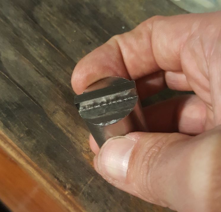

    I have hit a snag.. The carbide inserts pictured above use a proprietary size hole and are held in place normally with a pin and clamp arrangement. The hole is 3.8mm and there is no machine screw either metric or imperial which comes close enough for my liking for a snug fit so I decided what the heck, I will make custom screws. I started with 5mm metric hex head screws and turned the shaft down so its a nice snug fit in the 3.8mm hole. But now my problem. My ******* chinese tap and die set which I was going to cut a 3x.06mm thread with on the bottom of the screw is so terrible I suspect it would struggle to cut aluminium letalone a stainless screw.. It doesn't start cutting, just chews and scrapes and generally makes a dogs breakfast of it. And this is being held in a tailstock die holder with the screw head held firm in a collet.
    I suppose my next trick is to try cutting the threads with the lathe, although to date I have only done easy thread cutting, nothing anywhere near that fine so I guess I will have a crack and see what happens. Maybe if that also fails I will be forced into buying a new tap and die set. Although good sets seem to run well into the hundreds of $. Or I can rethink the toolpost situation, maybe I can get inserts with a friendly hole size?
