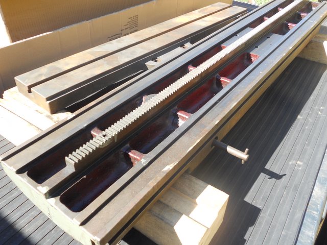

    I don't know about roller ways but ball ways may be easier to implement. Here's a photo of the ball bearing ways in a Makino C40 tool & cutter grinder, the model dates from the late 1950's, this one is from 1966 if I recall correctly. The ways are actually hardened steel and are removable. I don't know if they have to be ground in situ or whether you can slip a new set in to replace a worn set.
    Cheers,
    Mark

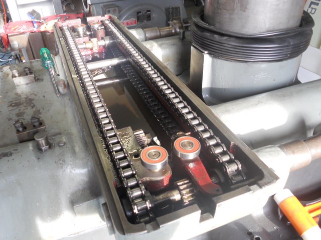

    Here's the roller ways on the Cincinatti #2 T&C Grinder
    The T&C grinder harty has, which is a Russian version of the Cincinatti, has rollers as well.
    Regards
    Ray

    That's an interesting way to have rollers and also apply drive too as the chain would move at half the speed of the rollers, looks like gears for a rack and pinion too though.
    Anyone know the model number for the old flat belt drive up the column Cincinnati tool & cutter grinder?. I suspect it's also a No.2 but the earliest version without the tilting motorised head. I've seen one apart and it has the ball rollers like the Makino.

    So Ray - what takes the load there? Is the table sitting on the roll chain (which are supported underneath?). If that were the case I would have thought there would be too much variation up and down.
    Michael

    Hi Michael,
    I don't have a good picture, but the table has flat ways that ride on the rollers, and as it happens they are worn in the middle on mine.. so yes it goes up and down..
    Regards
    Ray
